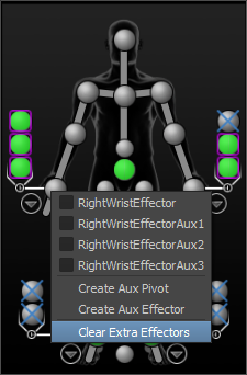

To delete all auxiliary pivots and auxiliary effectors for an effector in a Character in the Character Controls window:
