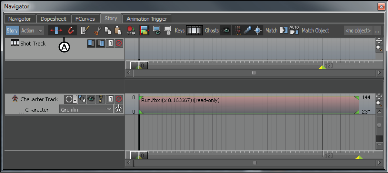

  1. Select a clip in the Story window.
  2. Select Scale in the Story Controls.
  3. Drag the start or end of the clip left or right until it is resized.
    Scale more than one clip at a time by selecting multiple clips and dragging the start or end of one of them. You can also double-click the frame number at the start or end of a selected clip and enter a new frame number.
    Story options A. Scaling is active

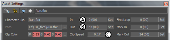

    When you double-click a clip in the Story window, the clip’s settings display in the Asset Settings window. Some of these settings also let you scale a selected clip.
    Changing the values in the In and Out fields (A and B) lets you scale a clip when Scaling is active. Changing the value in the Clip Speed field (C) lets you scale a clip with a precise value.
    Asset Settings window A. In field B. Out field C. Clip Speed field
