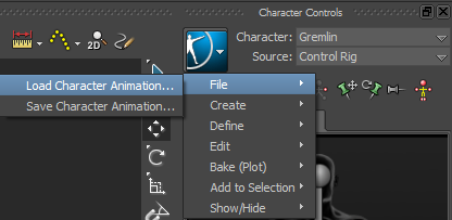

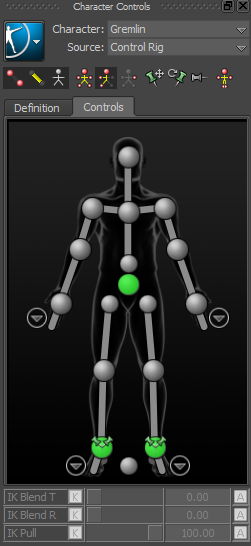

- Go to the Character Controls window.
- Left-click the Character Controls window menu button and choose File
Load Character Animation... from the context menu.

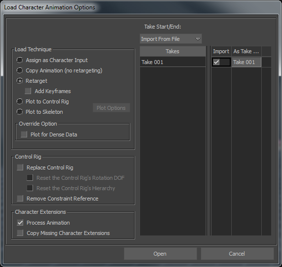

The Load Character Animation Options dialog appears.

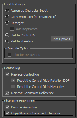

- In the Load Character Animation Options dialog, choose the following settings:
- Under the Load Technique group, select the Plot to Control Rig option.
- Under the Control Rig group, activate the Replace Control Rig option.
- Under the Control Rig group, activate the Reset Control Rig’s Rotation DOF option.
- Under the Control Rig group, activate the Remove Constraint Reference option.
- Under the Character Extensions group, ensure the Process Animation option is activated.
- Under the Character Extensions group, activate the Copy Missing Character Extensions option.
- Click Open.

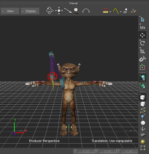

Mia’s animation, Control rig, and character extension are loaded onto the Gremlin character.
Mia’s animation and Control rig loaded onto the Gremlin character
Because Mia’s Servo arm is parented to her right shoulder effector, the Servo arm is attached in the same way to the Gremlin character.
