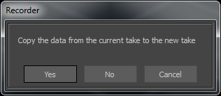

The Recorder dialog displays.
Recorder dialog
Creating a take enables you to save your biped in the "T" stance without having to add keyframes. It also enables you to save the biped in Take 001, as you imported it into MotionBuilder.

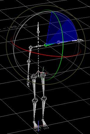

) or press R to enable rotation and rotate the skeleton's arm until it is parallel with the grid (Z in 0).
) at the bottom right of the Viewer window.
Skeleton's left shoulder rotated into a T-stance

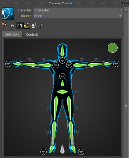

The Character Controls window displays a character representation in the Character Definition pane with a non valid characterization indicated by a red symbol (
) at the top right.
Character representation displays a non valid characterization

In the Character Controls window, the Character representation in the Definition pane displays a green symbol (
) at the top right indicating the characterization is valid.
Character representation displays a valid characterization
