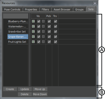

Sets window A. Column area B. Options area
The Column Area of the Sets window lists all of the sets you have created and gives you options for controlling the sets.
The following table shows the options available in the Column area:

The Sets option area, below the Sets column is where you find options for creating, copying, deleting, and reorganizing your sets.
The following table shows the options available in the Sets option area:
