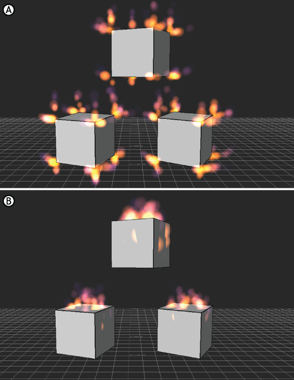

Use the Emit From menu to select from two particle display options:
Emits particles from the model’s vertices.
Emits particles from the model’s scaling volume
Emit From menu options A. Particles emitted from vertices B. Particles emitted from Scaling Volume

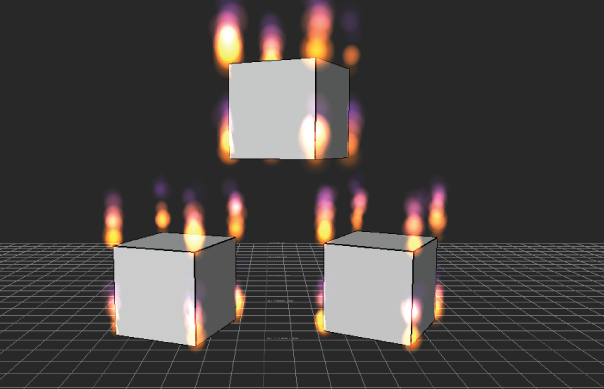

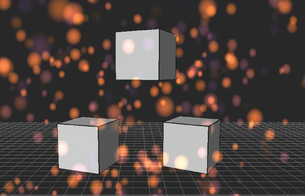

Use the Emit Radius slider to increase or decrease the radius of emission around a source.
Emit Radius value set to 100%.
