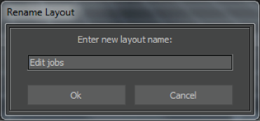

To rename the current layout:
Rename Layout dialog box

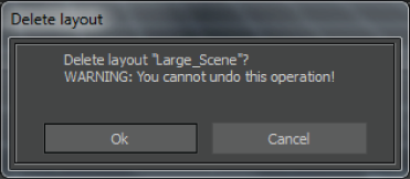

To delete a custom layout:
Click the custom layout you want to delete in the list that appears.
Delete Layout dialog box
When you delete a custom layout, MotionBuilder switches to the first default layout.
