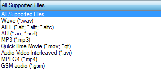

The following figure displays the supported audio files.
Supported audio file formats

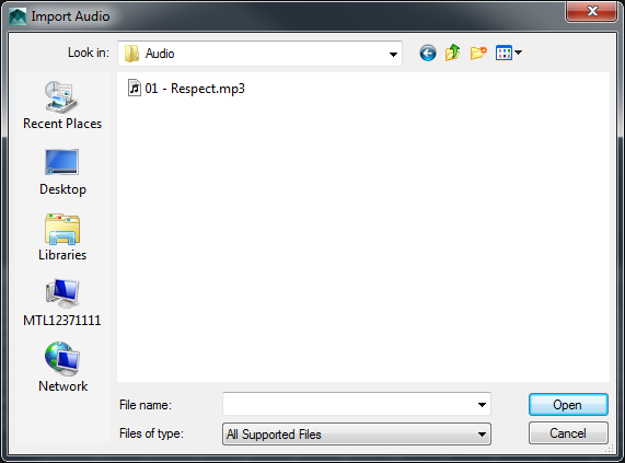

Open Audio Clip from the context menu. The Import Audio dialog appears.
