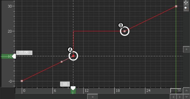

When the Step option is active, the Stepped interpolation maintains the selected keyframe’s value until the next keyframe.
Step interpolation A. Selected keyframe B. Next keyframe

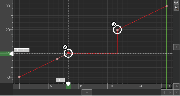

When the Step Next option is active, the Stepped interpolation maintains the next keyframe’s value until the next keyframe.
Step Next interpolation A. Selected keyframe B. Next keyframe
