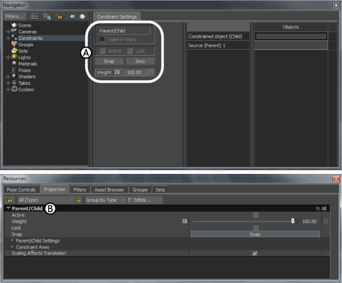

The Constraint settings contain controls that let you activate, offset, lock, and set other factors that govern the behavior of your constraints. These features are found in both the Navigator and Properties window constraint settings (see the following figure, A and B).
Constraint settings A. Navigator window B. Properties window

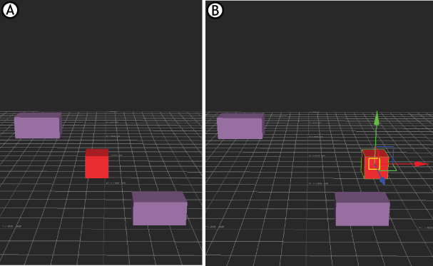

For example, in a Position constraint where two markers influence the position of a third marker, you can translate the third marker after the constraint is activated. You can do this in order to add a local offset to the constrained object.
Once you have applied an offset to the constrained object, activate the Lock option to save the offset. If you disable the constraint, translate the constrained object, then activate the constraint again. The constrained object returns to the position it was in when you originally enabled the Lock option. This is illustrated below.
You can move the constrained object after activating the constraint. A. Before activating the constraint B. After activating the constraint.

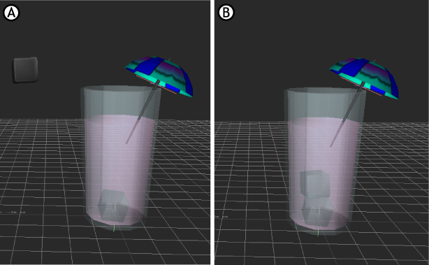

Click Snap to create an offset between the position, rotation, or scale of the constraint and the current position of the object being constrained. Snap is used when repositioning the constrained object and adding offsets.
Snap example A. The ice cube in a parent/child constraint before Snap is activated B. The ice cube after Snap is activated, inside the glass.
When you click Snap, the constraint is activated, but the offset between the constrained object’s current translation and rotation and its constrained translation and rotation is kept. This is useful when you want to activate a constraint, but you do not want to change its current position or rotation.
When a constraint is active, you can translate and rotate the constrained object to change its local offset. Click Snap to save the new offset. Disable the constraint, translate the constrained object, and then activate the constraint again. The constrained object returns to its position from the last time you clicked the Snap option.

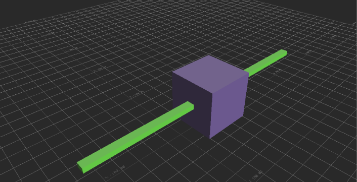

A cube is constrained and offset from its source object, the rod.
If you click the Zero option for this constraint, the offset is removed and the constrained object is placed at the position of the source object.
Click Zero to remove the offset and align the axes to the cube and rod.
