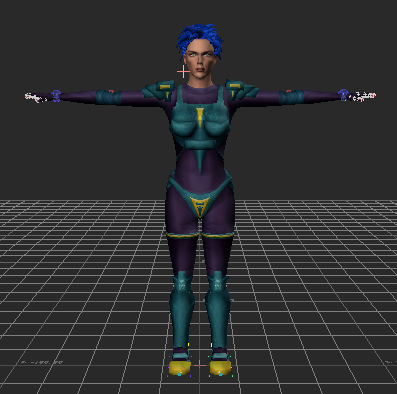

In the Viewer window, a model named Mia appears in the T-stance.
<No Animation>.

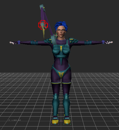

In the Viewer window, a Servo arm is positioned over Mia’s shoulder.
Mia and Servo arm loaded into the scene
