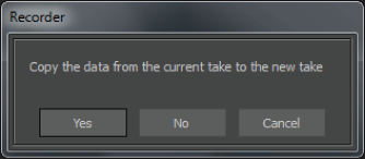

You can also duplicate takes by selecting a new take from the current take field. MotionBuilder asks you if you want to copy the data from the current take to the new take. Click Yes to copy the data or No to create an empty take. Click Cancel to abort the duplication process.
To duplicate a take in the Transport Controls:
Click Yes in the dialog box to copy the take.
