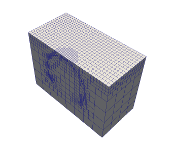

An Inconel 625 spherical geometry with support structures is built in a powder bed system using generic processing parameters. Both the part and support structure geometries are imported in the analysis through STL files and both are automatically meshed within Project Pan . The buildplate is modeled to be 10.88 mm thick using *DDM!. The time to deposit layers is calculated using the *PBDL card, here modeling the case where 5 identical geometries are built at once. The simulation is run twice, once without including powder, and one including powder in the multiscale analysis, using the *+PDR card. Powder properties are automatically scaled. Thermal conductivity of the powder is 0.01× that of the solid while specific heat is 0.6× that of the solid property. The bottom of the build plate is fixed using the *FSUB card. The *FSUB card will also simulate the release of the buildplate from the machine after the deposition process is complete, but before the part is removed from the buildplate. The mesh, shown with support elements, without support elements, and a cross section from the thermal analysis, with meshed powder, is shown in Figures 12.1.
Figure 12.1 (a) Sphere without supports
(b) Sphere with supports
(c) Sectioned sphere with powder elements
