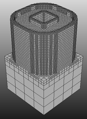

Mesh Preview
Click to generate a mesh preview of the active part and build plate. The preview generates quickly, and is handy for showing significant mesh flaws or other issues that should be fixed before running a full simulation. It is recommended to adjust the mesh setting so that the thinnest geometric feature has at least 2 elements through its thickness to ensure that the simulation can freely distort.
Sample Mesh Preview
