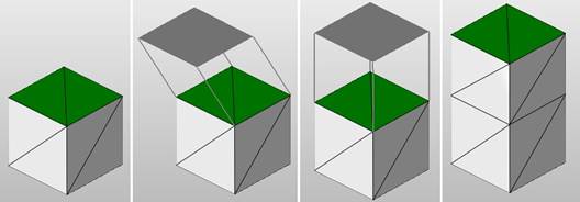

Extrusion of a Box: First, select surface. Second, pull the surface out in any direction by drag & drop. Third, align the extrusion by double-clicking on the original surface. Fourth, by applying the extrusion the box is expanded.

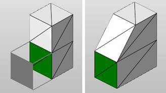

Similarly, by double-clicking on a triangle edge, the extrusion is aligned along the edge, switching the direction with every double-click. With the button Apply in the tabsheet, the extrusion is performed. The chosen triangles are moved according to your settings and new triangles are inserted to connect the original part with the new triangles.

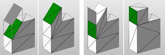

If the option Move Points is activated, the module does not add new triangles to expand the part, but simply moves the points of the selected triangles. That way, all neighboring triangles are repositioned to connect the old part and the new surfaces. This can lead to a different kind of shape as the standard extrusion. The direction of the extrusion along the three axes and the distance to the original surface can also be set in the parameters box in the tabsheet to the right. You have three fields for the direction, representing the X-, Y- and Z-axes. The proportion of the number you enter here determines the direction of the extrusion.
Move points: Only the corner points of triangles are drawn outwards, changing the shape of all adjacent triangles.

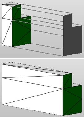

Left: This extrusion is aligned to the top surface, not to the original surface. Right: Here, the surface is extruded along one of its own edges. Combined with "Move Points", it is simply pushed upwards and the surface below is stretched

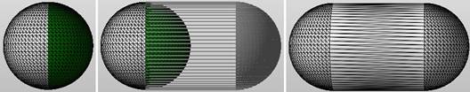

Extrusion of one half of a Sphere.
