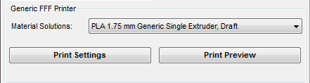

Print Settings
The print settings are accessed using the Print Settings button.
After you define the print settings, you can add them to a custom profile. You can also remove an existing custom profile, export a profile, import a previously defined profile, or rename a custom profile.
