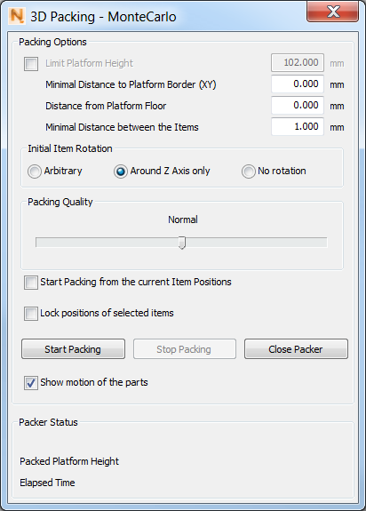

Dialog for different settings of the packer.
You can set distances for parts from the wall, the floor and in between parts. It is also possible to define whether parts should be rotated. Finally use the slider to set the Packing Quality. The quality defines the allow deviation from the set distance values to perform the packing, the higher the quality, the stricter the packer will adhere to the setting with the downside of taking longer to finish.
