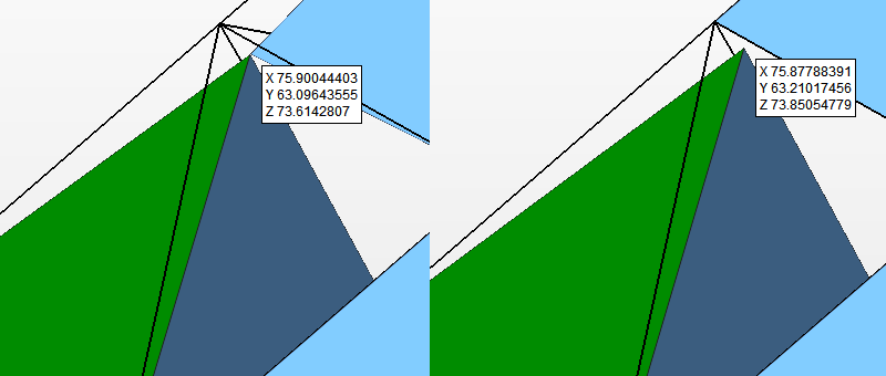

Individual shells sharing unique nodes can lead to problems during manufacturing workflow. With this Action, available for use in user-defined Repair scripts, each shell will receive their own nodes.
Figure 8.45: Moving a node belonging to multiple shells. Left: Before sanitizing. Right: Sanitized.
