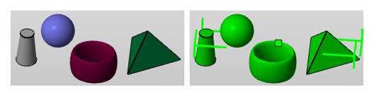

At least two parts have to be selected for this function. Multiple selected parts are unified to form one single part containing all shells of the original parts. The original parts can be either replaced by the new part or be left in the project.
Four parts become one part with four shells.
