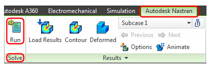

The default analysis setup is suitable for this simple linear static stress analysis example. We can proceed immediately to running the solution.
  1. Click Autodesk Nastran Solve Run.
    The Autodesk Nastran Output log is shown in the browser frame while the solution progresses.
