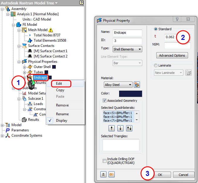

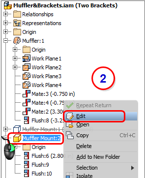

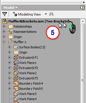

Start Autodesk Inventor, and open Muffler&Brackets.iam from the Section 23 - Muffler - Modal Avoidance folder of your training exercises folder.
From the ribbon, click the Environments tab, and click Autodesk Nastran In-CAD.

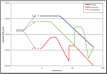

The 380 Hz and 410 Hz modes are very near the drop off region in the road load longitudinal curve. Pushing these modes up 20 to 25% could reduce their sensitivity to this frequency. We can thicken the bulkheads and end caps to shift these modes.
Similarly, the 102 Hz mode is close to the drop off in the road load transverse curve. This would require a 200-330% increase to justify the change. However, increased material thickness on a small part will have a minor cost impact.
Return to Autodesk Nastran In-CAD by clicking Environments, and then Autodesk Nastran In-CAD.

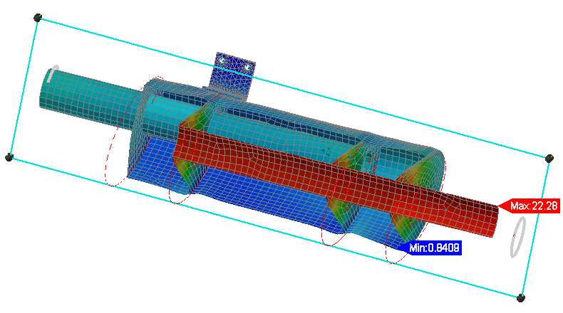

We can see that the longitudinal modes were pushed exactly where they needed to go to minimize the possibility of vibration-related failure.

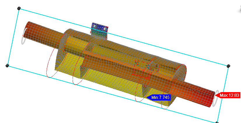

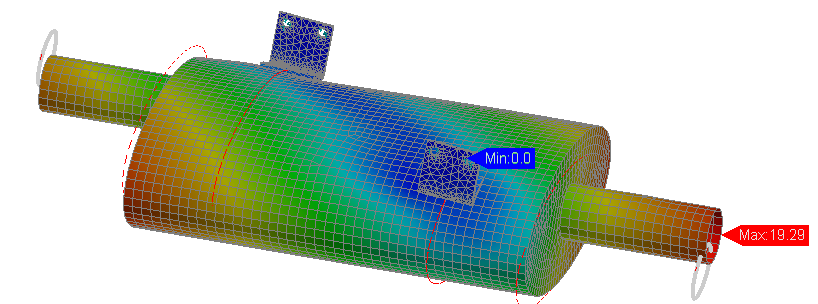

Mode 1:
Mode 2:
Mode 3:

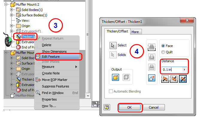

In this exercise we modified the geometry to drive the questionable modes out of the peak energy portions of the curve. This was done by increasing the thickness of the end caps and the brackets.
