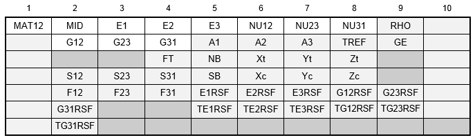

Solid Element Orthotropic Material Property Definition
Description: Defines the material property for an orthotropic material for isoparametric solid elements.
Format:

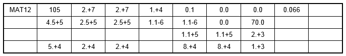

Example:
