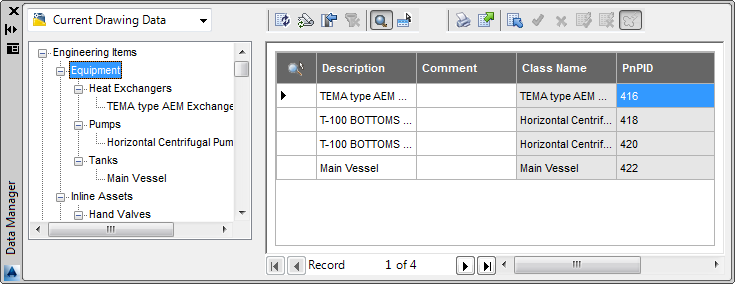

Data Manager
Displays data that can be viewed, modified, exported, and imported.
Find
 Ribbon: Click Home tab Project panel Data Manager
 Shortcut menu: Project Manager Reports flyout Data Manager or Reports.
 Command entry:  datamanager
A tree view in the left pane of the Data Manager displays object views, customized views, or reports. The data view in the right pane displays properties for the selected view or report.

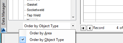

When viewing a Plant 3D drawing, you see a drop-down list that offers these choices:
You can change the way the tree is organized, by choosing area or object type.

Data Manager Toolbar
Provides buttons that export and import data, accept and reject pending changes, filter or zoom, and so on.
  • Drop-down List. Sets the Data Manager view. You can choose drawing data, project data, or project reports. You can also select a customized view, if one is available.
  •   Refresh. Refreshes the tree and data views.
  •   Synchronize PID Symbols and Annotations. Updates the symbols and annotations with changes made by other designers in project drawings.
  •   Hide/Show Blank Columns. Hides or shows columns in the data table with no data in them.
  •   Remove Filter. Removes all current filters on the data table.
  •   Turn Zoom Toggle On/Off. Turns on or off persistent zoom so that you zoom to any component or line in the drawing when you select its row header in the data table.
  •   Show Selected/All Items. Turns on or off the filter that shows data only for items you select in the drawing.
  •   Print. Prints the data view.
  •   Export. Opens the Export Data dialog box or Export Report Data dialog box, where you choose where to export XLS, XLSX or CSV files.
  •   Import. Opens the Import From dialog box, where you select the XLS, XLSX, or CSV files to import.
  •   Accept. Accepts the selected pending change from the import.
  •   Reject. Rejects the selected pending change from the import.
  •   Accept All. Accepts all pending changes from the import.
  •   Reject All. Rejects all pending changes from the import.
  •   Hide Revision Clouds. Hides or shows the red cloud around those components whose data was modified during import (P&ID only).
