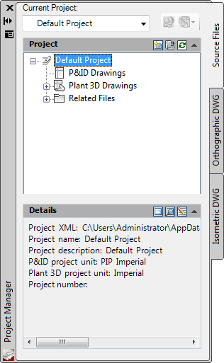

Project Manager
Assembles and manages drawings belonging to a project.
 Ribbon: Click Home tab Project panel Project Manager
 Command entry:  projectmanager
Project Controls
Provides a way to open projects and run project reports.
Project Name
Displays the name of the current project. By default, the last project you opened is displayed.
The first time you open the Project Manager, a default project is displayed. The Project Name list also displays the following options:
  • Previously Opened Projects. Displays a list of the most recently opened projects.
  • Open. Displays the Open dialog box, where you can find and select an existing project.xml file.
  • New Project. Displays the Project Setup Wizard.
  • Sample Project. Displays the sample project provided with the product.
Publish button
Displays the Publish dialog box.
Reports button
Displays a list of reports that you can run, including custom reports.
  • Data Manager. Displays the Data Manager.
  • Export Data. Displays the Export Report Data dialog box.
  • Import Data. Opens the Import From dialog box.
  • Reports. Opens the Data Manager in Project Reports mode.
Project Panel
Sets the overall organization for the drawings in the project.
You can add, remove, and reorder drawings and folders. You can also select drawings or folders to include their data in reports.
Project Panel Toolbar
Provides buttons that open, add, and refresh the status of drawings.
  •   New Drawing. Displays the New DWG dialog box, where you can create a new drawing based on the default template and add it to the project tree.
  •   Copy Drawing to Project. Opens the Select Drawings to Copy to Project dialog box, where you can select one or more files to copy to the project.
  •   Refresh DWG Status. Verifies whether any of the drawings or files in the project are being edited by another user.
  • Note: Refresh can also synchronize the drawing with the project. Automatic synchronization is set with synchstylesmode.
Project Tree Nodes
Each node in the project tree is designated by a specific icon.
  •   Project Node. Represents the top-level organizational unit in the project tree hierarchy.
  •   P&ID Drawings Node. Represents a default grouping for P&ID drawings that cannot be removed. You can add nested folders within this folder.
  •   Plant 3D Drawings Node. Represents a default grouping for Plant 3D drawings that cannot be removed. You can add nested folders within this folder.
  •   Related Files Node. Represents a default grouping for Related Files that cannot be removed. Also represents folders that you can create under any default grouping.
  •   Drawing Node. Represents a drawing in the project.
  •   Locked Drawing Node. Represents a drawing that is currently being edited.
  •   Missing Drawing Node. Represents a drawing that has been moved or removed.
  •   Referenced Drawing (Xref) Node. Represents a drawing that is referenced by the project but does not belong to the project.
  •   Project Referenced Drawing (Xref) Node. Represents a drawing that is referenced by and belongs to the project.
Details Panel
Provides information about the project or about drawings selected in the Project Manager tree area.
To change the display, click the corresponding button on the Details panel toolbar.
Details
Displays information about the selected node.
  • Project details. Displays project information, including project location, name, description, unit type, and number.
  • Drawing details. Displays the drawing status, description, file name, location, file size, and the save and edit dates.
Preview
When a drawing node is selected, displays a small preview of the drawing.
Work History (Source Files tab only)
When a drawing is selected, displays all work history entries for the drawing.
Times and dates use the current Windows system settings.
  • Date Modified. Displays the date and time of the edits associated with the most recent work history entry.
  • User. Displays the login name of the person who opened the drawing for editing.
  • Status. Displays the status of the drawing. Status categories differ, depending on the standards used by your business. They may include the following:
    • Unassigned. No status is assigned.
    • In Progress. Project is open for editing.
    • For Review. Project is ready for review.
    • Revision 1-4. Draft number of the project.
    • Final. Project is final.
    • Archive. Project is ready to be archived.
    • Manage. Displays the Project Status Manager, where you can customize the status options.
  • Notes. Displays descriptions entered by the individual updating the work history. Only the originator of the work history record can update existing notes.
