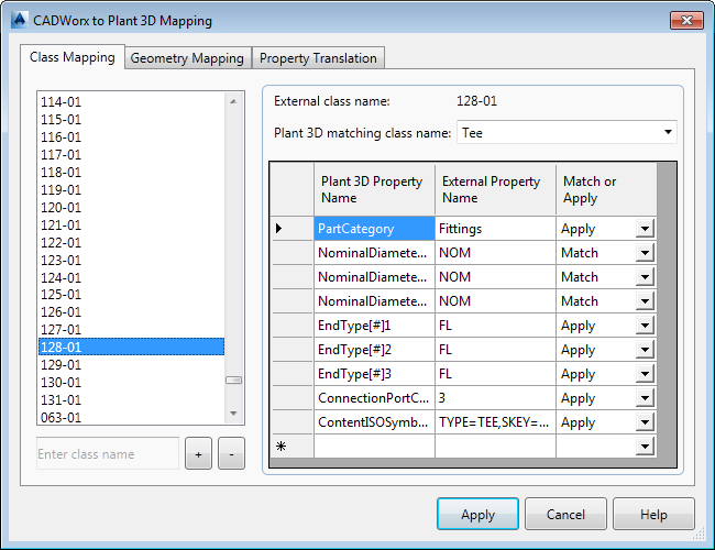

Maps global and individual class CADWorx properties to Plant 3D equivalents
Maps global class properties and external classes to Plant 3D classes and properties.
To reorder the class list, right-click and click Move up or Move down. Alternatively, you can press + or -.
Lists global properties that apply to all classes. Once these properties are mapped, you need not map them again for individual classes.
Lists CADWorx classes (represented by numbers) that can map to a Plant 3D class.
Adds new AutoPLANT class names to the External Class Names list. Enter text into the box and click the + button to add a class name.
To reuse existing mappings, right-click an existing class to copy the mapping information and then right-click the new class to paste the information. This action affects only this tab.
Adds a new CADWorx class name to the External Class Names list.
Deletes an CADWorx class name from the External Class Names list.
Displays the CADWorx class name selected from the External Class Names list on the left pane.
Specifies the Plant 3D class that corresponds to the CADWorx class selected on the left pane. When you select one of the global mappings this field is read-only.
Specifies the Plant 3D properties that you want mapped to the CADWorx properties for the class selected on the left pane.
Specifies the CADWorx properties for the class selected on the left pane.
Specifies whether you want to match the properties or apply a specific property value. For example, for the CADWorx 128-01 class, the Plant 3D NominalDiameter property is set to match CADWorx NOM. But the Plant 3D PartCategory property is set to apply the specific value Fasteners.
