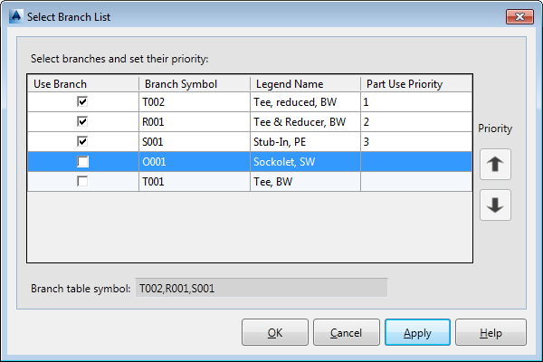

Sets the preferred order of branch components used when routing and branching pipe in AutoCAD Plant 3D.
Specifies whether the branch type is included in the branch list.
Displays the Branch Symbol for the branch type. You can add and remove branch symbols in the Branch Table Setup dialog box.
Displays the priority for the branch type.
Sets the priority for the branch type.
