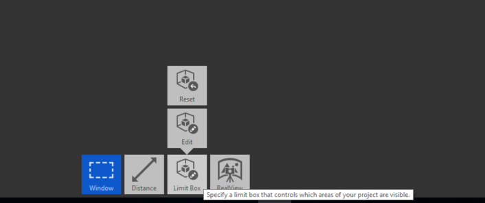

Access the Limit Box tools through the button in the tool bar:

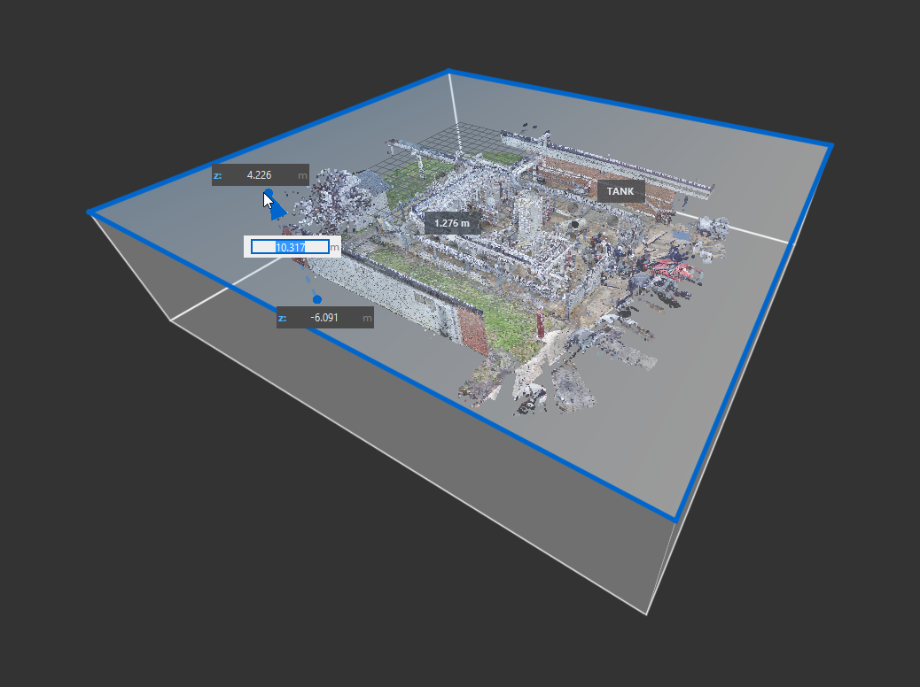

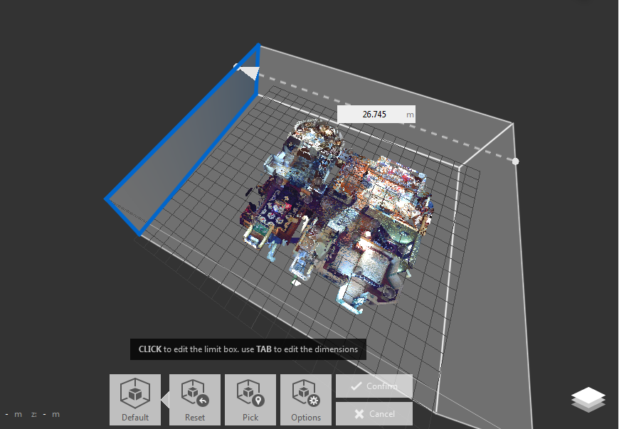

Hovering over a face on the Limit Box highlights it and provides contextual feedback about the distance between it and the opposite face along that axis. To adjust the box simply click and drag one of the faces. The measurement will be updated in real time to provide concise feedback.
By default, the Limit Box tool will select the faces of the Limit Box from the outside. There is also the option to select and edit the inner faces. To do this, verify that "user inner faces" is active from the Point Cloud Options found in the contextual tools and hold the Shift key to quickly toggle between forward and back-facing surfaces.
When hovering on a face, you can cycle through the box's dimensions with the Tab key. This allows you to edit and enter precise values for each. Once you rotate the Limit Box out of the default world coordinate system, you will no longer be able to edit precise endpoints along the x, y, or z axes.

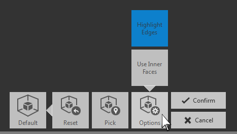

Limit Box Options

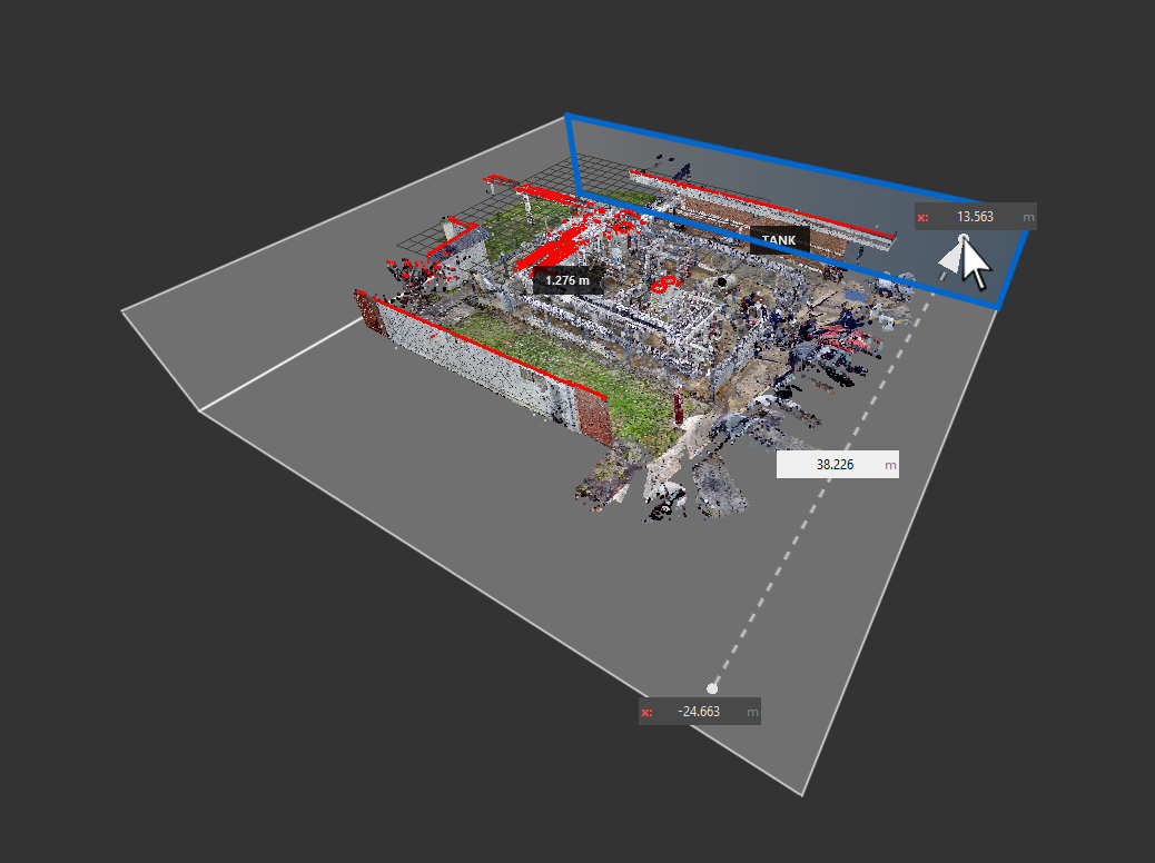

Edge Highlighting turns on red highlighting to display which points intersect with the boundary of the Limit Box as you adjust its volume and rotation. Use this option, for example, when the boundaries of the Limit Box are close to a building or other feature.
Available through the Contextual tile menu:

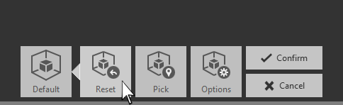

Resetting the Limit Box allows you to quickly reset the box to its original bounds and is available through the Contextual tile menu:

  1. On the Project tile menu, hover over Limit Box and click Edit.
