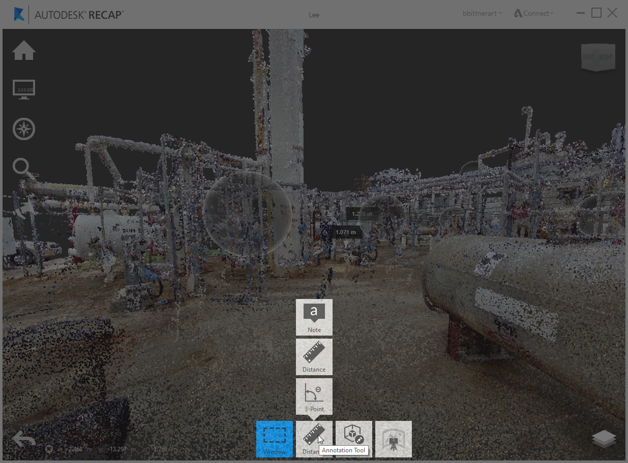

Access the Distance Menu through the lower Contextual tool menu, typically through an annotative or measurement tile. This will generate the Distance Menu flyout:

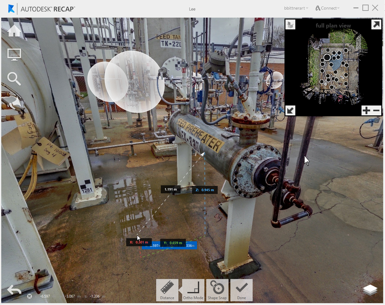

Freehand Distance
The Freehand distance tool is available in 3D and RealView mode and simply defines the linear distance and x, y, and z coordinates after selecting 2 points. You can toggle through the Distance Menu by pressing the Shift key to define your endpoint with a different tool (eg, to measure distance to the center of a pipe or select an endpoint orthogonal to the x axis).

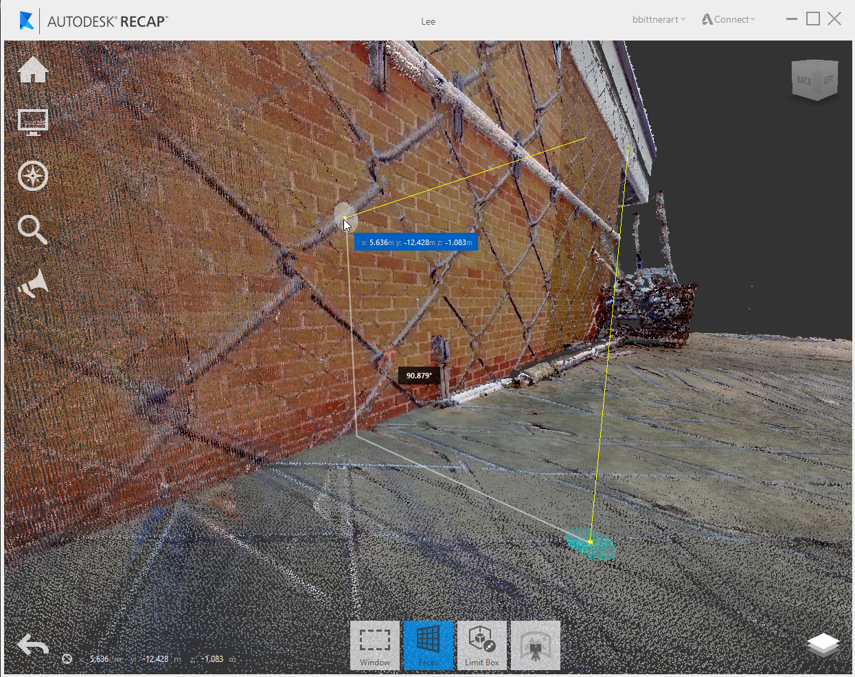

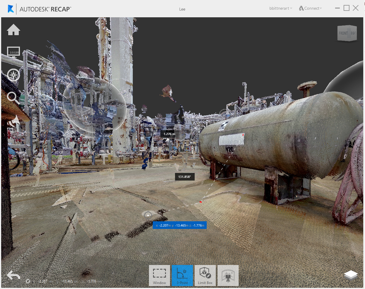

3-Point and Faces
Faces and 3-Point tools measure angles. Placing a an angle measurement is very simple and can be derived quickly by selecting 3 points or 2 faces, depending on the mode selected.
3-Point
Faces

A number of extra features available within ReCap 360's distance features can reveal additional functionality for obtaining specific measurements. In the example above, we can see that the distance tool provides real-time feedback on the distance between the two primary points as well as secondary information around the scene's x, y and z planes.
As with the rest of ReCap 360's measurement tools, endpoints can be repositioned at any time through simply clicking and dragging, measurements can be copied to the clipboard and pasted into essentially any program, physical representation of the measurement can be hidden through the "eye" icon, and notes and/or images can be attached.

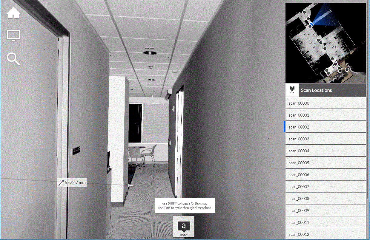

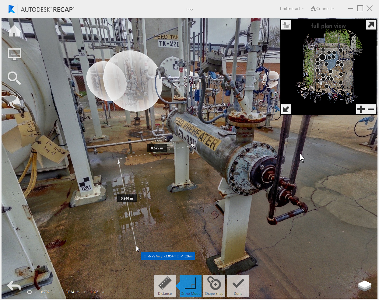

Ortho Snap
You can also switch into any of the Ortho Snap modes at any time by pressing the Shift key until your reach your desired tool, or directly through the Distance Menu flyout.

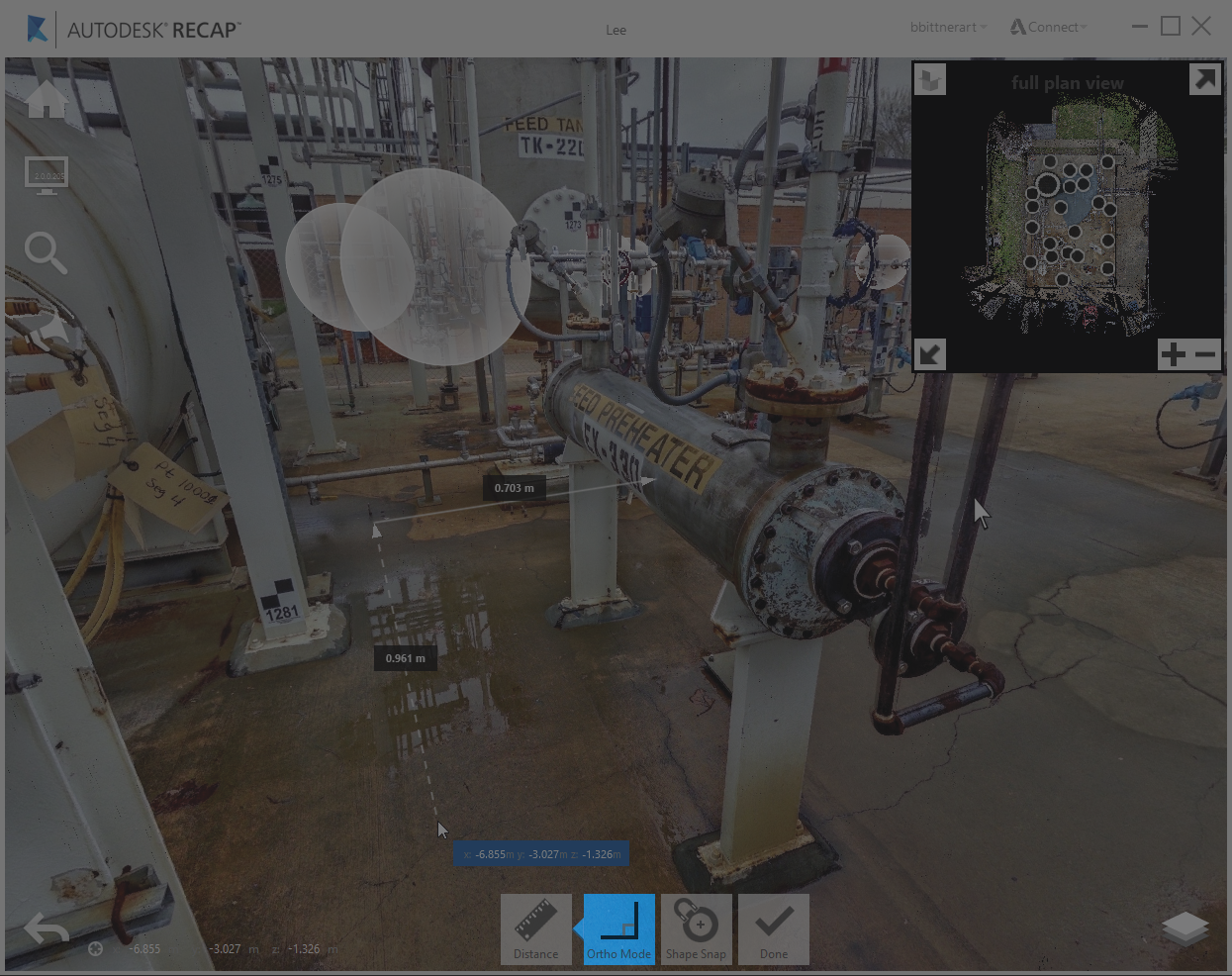

Once Ortho mode is activated, your chosen tool provides measurements based on the horizontal and vertical axes related to the two points.
The longer of the two lines will be selected by default. You can switch between the selected measurements with the Shift key.
