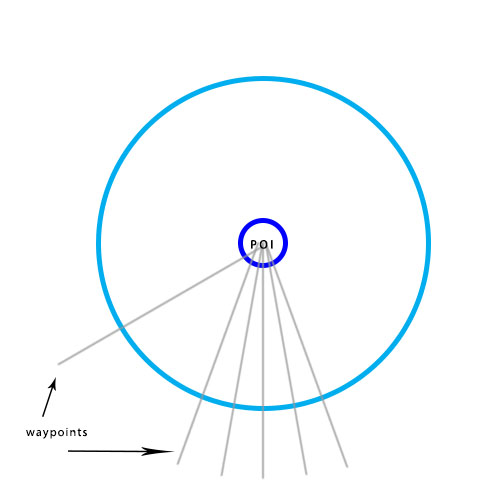

The schematic below reflects a simple circular orbit with a waypoint at every 10°, which would produce 36 photos:
The above is an example of a recommended method for many capture cases, and applies very well to simple square or circular structures, such as buildings; essentially, normally shaped structures with a close 1W:1L ratio. Other areas, such as football fields or other large areas, tend to be mapped under a lawnmower-style UAV flight pattern.

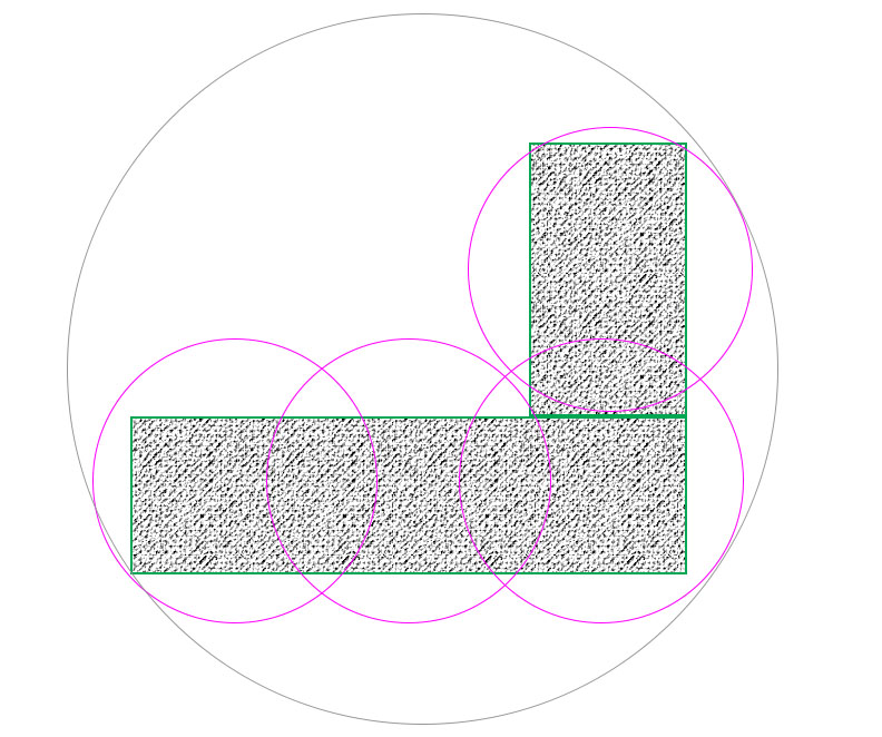

Alternately shaped objects might require additional orbits in order to gather the scene. This might involve adding some additional radii or elevations to the flight program:
