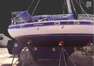

In a scan project, point data is captured using 3D laser scans, and aligned with a referenced coordinate system. Generally, a survey company will provide correctly oriented scans in the native scan format of the scanner manufacturer.
In a photogrammetry project, often called simply a photo project, ReCap 360 Pro analyzes a series of photos to measure distances between objects, map exact surface points, and create mesh. As a result, users can develop textured, high-resolution, geometrically precise 3D models from simple photographs. This feature is accessible as an exclusive cloud service on the web at recap360.autodesk.com.

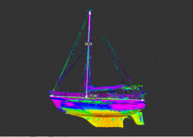

A number of methods are available to organize the indexed data to remove or hide portions of the point cloud. Create Scan Regions that you can turn on and off, specify temporary clip regions, turn off or remove scan files, or delete unwanted points permanently. By viewing the scene using different color modes and lighting, you can gain insight into elevations, normals (which help identify surfaces), and reflectivity.
