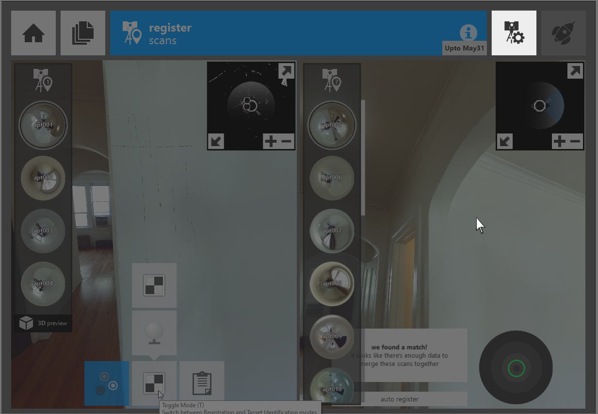

A variety of settings can be applied before the project is indexed and finalized into the unified point cloud. These can accessed from the Settings tab at any time during the project creation process.
[Noise] filter: Determines how aggressively stray points are excluded from the imported scan file.
Distance range: Sets which points are included in the imported scan based on a minimum and maximum distance from the scanner.
Intensity range: Sets the range of points that are imported based on intensity (reflection) values.
Decimation grid: Controls the number of points to import by specifying the smallest cubic volume that a single point can occupy. Lower values improve the quality of the point cloud but also increase the file size.
Coordinate system: Aligns the point cloud with a specific EPSG Geodetic Parameter Dataset coordinate reference system.
Up axis: Appoints the "up" axis.
