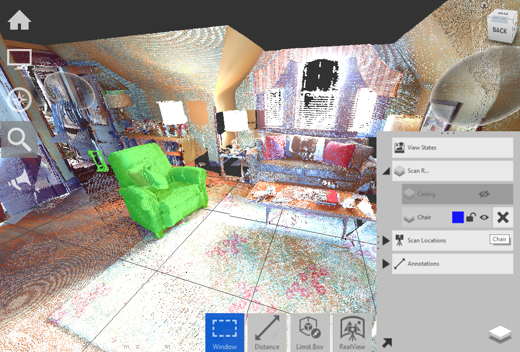

The regions are identified by different colors, which you can change. The following example shows a building with its "Chair" region selected:

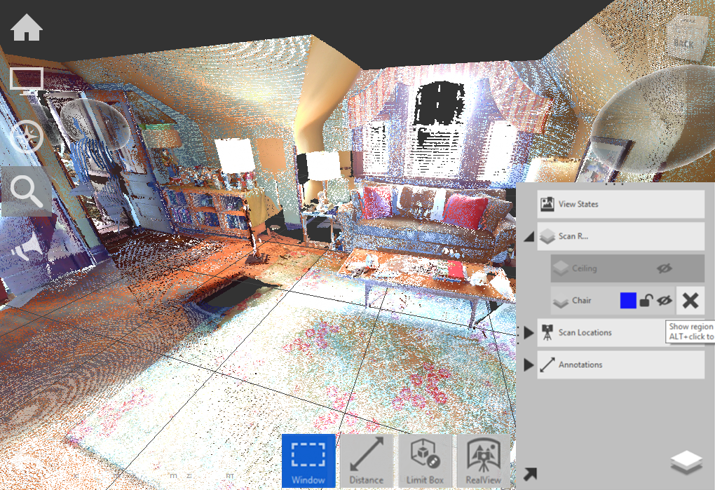

You can turn off Scan Regions that you want to hide so that you can visualize the space without the features in those regions. In the following example, the Scan Region "Chair" has been hidden.
