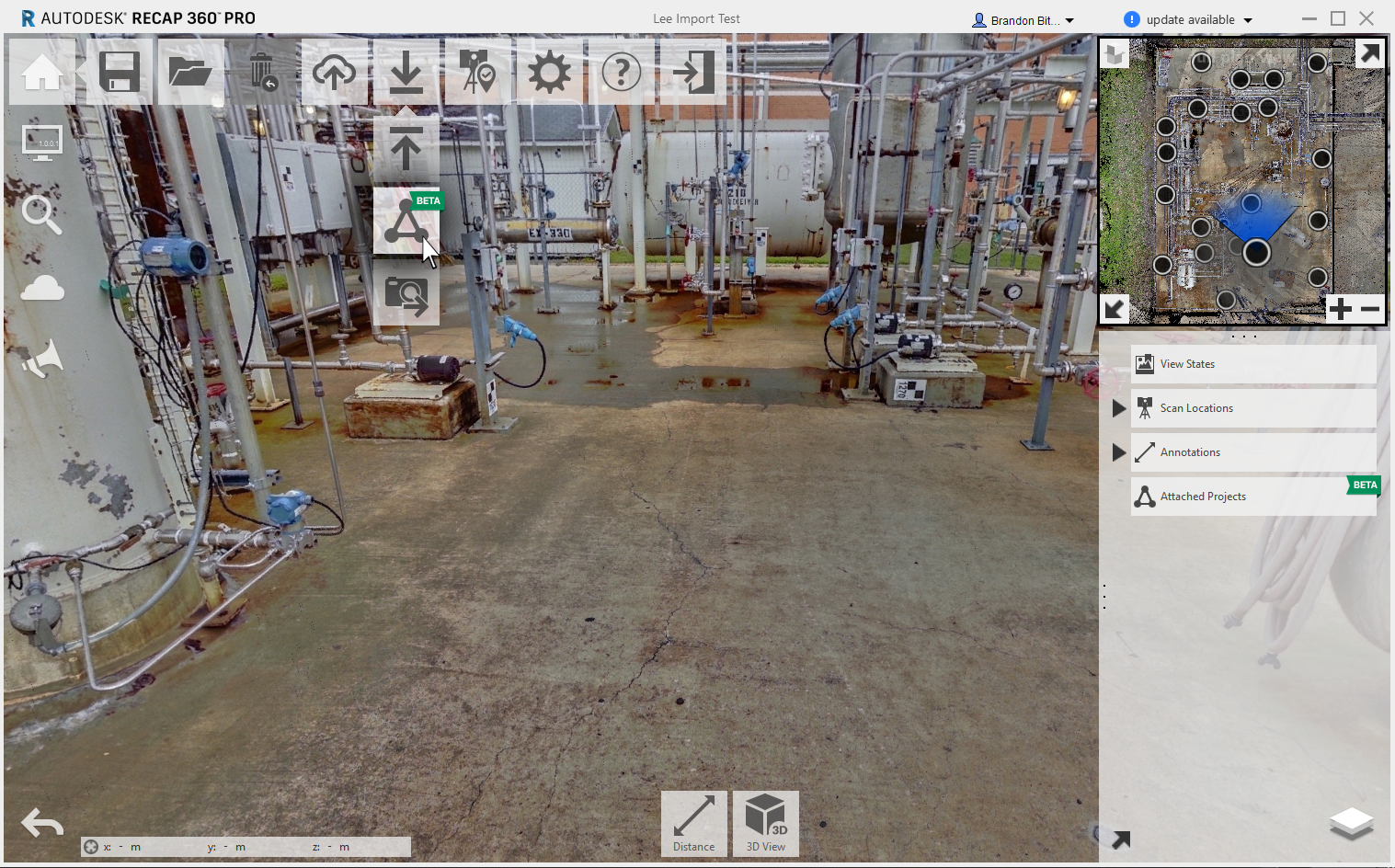

Access the tool from the home menu flyout, under the Import/Export drop-down:

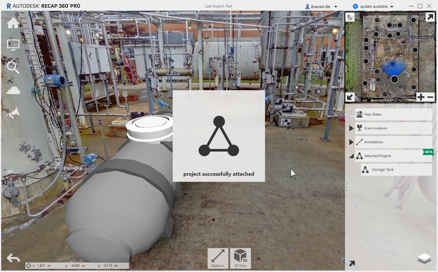

After you choose a file from the file explorer, a brief pop-up lets you know that the file has been attached successfully:

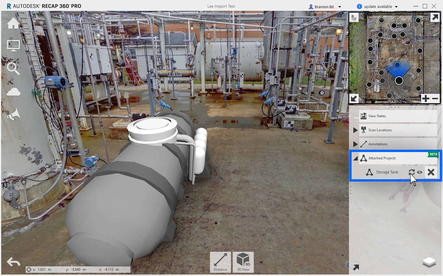

Attached projects are available within the project manager. From here you can toggle project visibility, refresh the project, or delete it.
When an attached project is refreshed, you are syncing any updates made to the file outside of ReCap. Updates to the project won't be visible until a refresh is executed when the ReCap project is reloaded.
