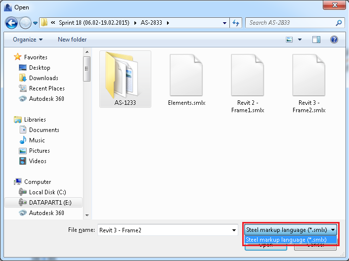

Transferred File Formats
The .smlx format is the main format used by the extension, but other supported formats also include IFC, CIS/2, PSS, SDNF.

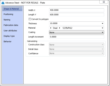

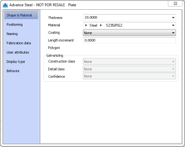

Advance Steel plates are imported in Revit as plate families.
In order to import plates in Revit, you need to perform the following in the Settings menu:
These plates are imported back in Advance Steel as plate objects.
The images below display a model in Advance Steel that contains a rectangular, polygonal and circular plate. The model was transferred to Revit and then was sent back to Advance Steel through .smlx. The plates are imported in Advance Steel as plate objects.

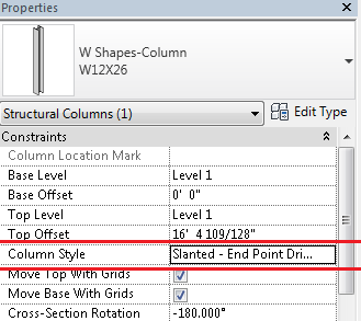

Columns are transferred in Revit as structural columns, Slanted - End Point Driven, regardless of the angle in the Advance Steel model. In Advance Steel they are imported as columns and have the model role set to Column.
The images below display a model in Advance Steel that contains several slanted and vertical columns. The model was transferred to Revit, where the columns were imported with the Slanted - End Point Driven column style.

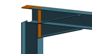

A steel connection is an assembly of steel objects and cuts that joins two or multiple steel members (i.e. a connection between a column and a beam).
The following images show an example of the most transferred joints, explaining how each type of object is transferred in Revit (i.e. a plate will be created, but a bolt or a beam notch will not etc).
| ADVANCE STEEL | REVIT |
Clip angle![]() |
Shear plate![]() |
Moment end plate![]() |
Apex haunch![]() |
