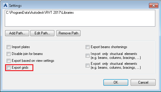

Transfer and synchronize grid elements between Revit and Advance Steel using the option in the Settings dialog.
The Export grids option allows you to transfer grid elements when starting a new project. This is a checkbox option and by not checking it, you can choose not to take the grid elements into consideration in the following synchronization iterations, when the focus is no longer on the basics of the structure.
