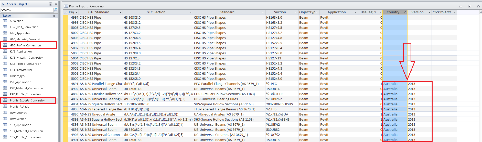

In order for the country column to be used in the transfer, the version column must be filled with a value, inside the GTC_Profile_Conversion and Profile_Export_Conversion tables of the GTCMapping.mdb.
Profile names are translated inside the AstorProfiles.mdb database. This translation can be different from one version to another. Additional mapping lines must be added inside the GTCMapping.mdb database with regular expressions that catch the new translated name. Because of this, the mapping lines contain a version number. For the country dependent columns to be read they must have a version, otherwise they will not be used in the transfer.
