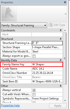

These families contain 2 newly created parameters:

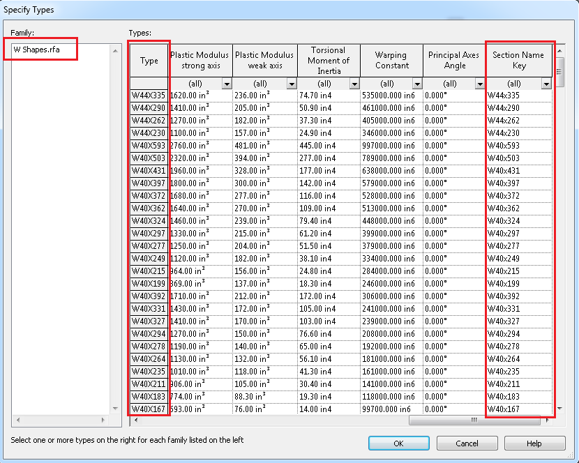

The Family Name key parameter is mapped 1 to 1 to the Table Name from Advance Steel. This parameter is stored in the family.
There is also a table inside AstorProfiles2017.mdb, called RevitASProfileConversion. This table stores the mapping between the Revit Family Name Key and Advance Steel Profile Table.
The Section Name key parameter is mapped 1 to 1 to the SectionName value of a profile in Advance Steel. This parameter is stored in the family.
