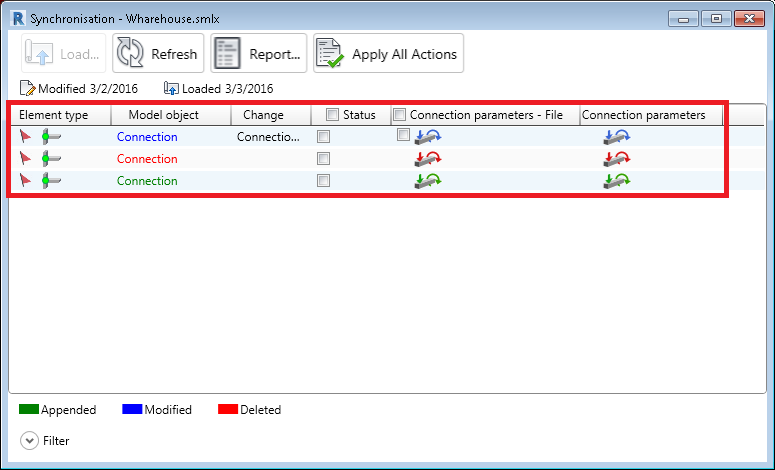

The Synchronization dialog was improved to display any appended, deleted or modified connections:
When a steel connection is exported to the . smlx format, all parameters from the parameters menu of the steel connection, will be exported in the xml file.
If a .smlx file is synchronized with the model, the connection parameters are compared. If any of the parameter values is changed, a Modified line will be displayed in the Synchronization dialog. The change is reflected in the Synchronization dialog by displaying Connection parameters, in the Change column.
You can also load two other fields in the dialog: Connection parameters - File and Connection parameters.
When you select and apply a connection line, all the connection parameters are pushed to the model connection - there is no option to apply only part of the connection parameters.
A connection filter is available in the Synchronization dialog. Using this filter you can display or hide the Connection lines in the window.
Steel connection macros have versions and this property is exported inside the . smlx file. The version of a macro changes when the macro is updated with additional parameters. If connection versions are different between the file and the model, the synchronization dialog will only apply the common parameters for the two versions. Because the . smlx file version of the connection cannot be changed by synchronization, the dialog will display a parameter difference after using Apply all actions.

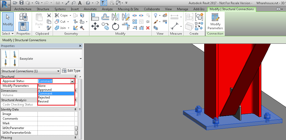

The Approval status set for the steel connections is also transferred and synchronized between Revit and Advance Steel.
You can find this parameter in Revit, in the Properties palette, when a steel connection is selected:

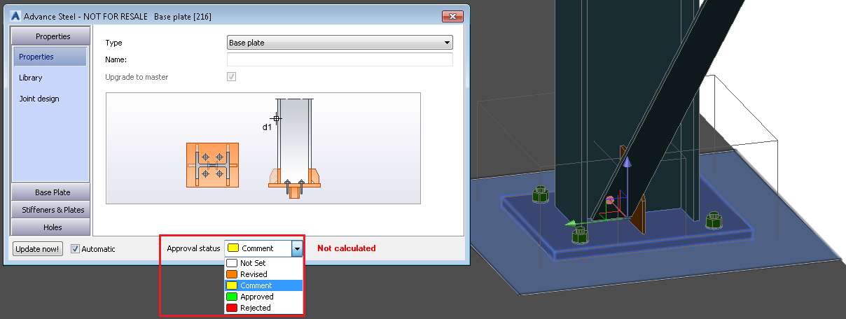

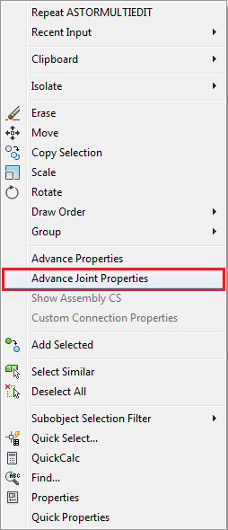

In Advance Steel, the approval status is located in the Advance Joint Properties dialog. To access the dialog, double click on the connection box or select the connection box or any connection element, right-click and choose Advance Joint Properties from the contextual menu:
The synchronization dialog spots any modification of the approval status. The change is reflected in the Synchronization dialog, by displaying Approval status in the Change column. The differences between the file and the model values can be displayed by loading the Approval status - File and Approval status fields.
The Advance Steel database (AstorBase > ApprovalStatus table) contains the following values:
In Revit, approval statuses can be added in the Parameters tab of the Structural Connection Settings dialog, that can be accessed from the Structure tab > Connection panel. By default, Revit only has the None approval status. This Revit default status is the equivalent of the Advance Steel Not Set status; therefore, the synchronization dialog will not spot any difference between these two values.
The synchronization dialog only spots the approval status values that come by default with Advance Steel (Not Set, Revised, Comment, Approved and Rejected). Any additional values that you create in Advance Steel or Revit will not be recognized and will be evaluated as a Not Set value. If the Revit model does not contain the Advance Steel default approval statuses, they will be created automatically when the lines in the synchronization dialog are applied to the model.
