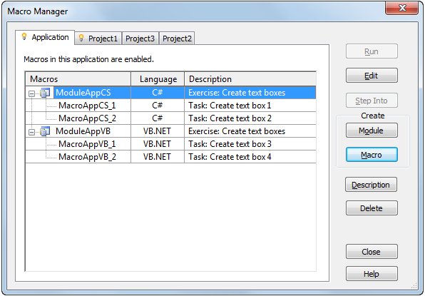

Macro Manager is the user interface for:
Shown below is the Macro Manager screen:
The tabs indicate the scope or level of a macro.
You add, modify, build, and delete modules and macros from these tabs.

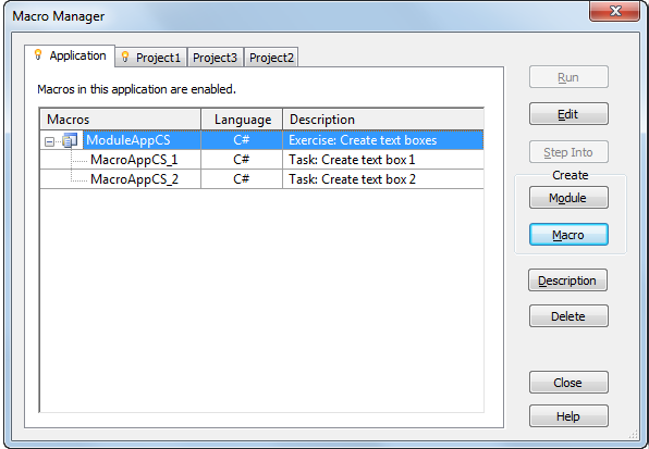

Macros and Modules
A module is an organizational grouping of macros. Macros can be either independent within a module when they run, or share code or utilities with each other. They are arranged in the Macro Manager as follows with the macros organized under their parent module.
Macros within a module are seen and built together. The icons representing the module also show their current state.
