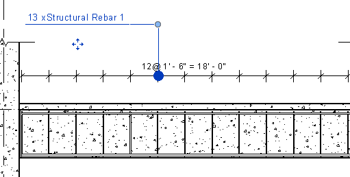

You can modify multi-rebar annotations like other tags.
- In the project, select a multi-rebar annotation.
- Click Modify | Multi Rebar Annotations tab
Edit panel
Select Tag. The tag highlights in the drawing area.

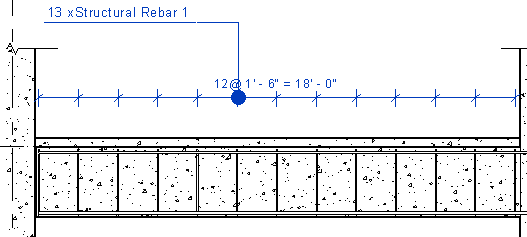

Click the tag handle to drag the leader to a new position.
