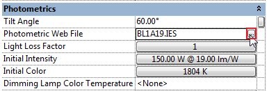

  3. Specify the IES file to use.
    1. If you want the IES file to define light distribution for the entire lighting fixture family, keep the lighting fixture family open in the Family Editor. Click Properties panel (Family Types). For Name, select the family type to modify.
    2. If you want the IES file to define light distribution for selected instances of the lighting fixture family, open a project that uses it, and select a lighting fixture in the project. Click Modify | Lighting Fixtures tabProperties panel (Type Properties). Click Duplicate, specify a name for the new family type, and click OK.
    3. In the list of parameters, scroll down to Photometrics.
    4. For Photometric Web File, click in the Value column.
    5. Click (Browse).
      Note: The Browse button displays after you click in the field.
    6. Navigate to the desired IES file, select it, and click Open.
    7. Click OK.
    8. Save changes to the project or the lighting fixture family.
In the drawing area, the shape of the light source reflects the specified IES file. (To see the light source in a project view, you must make light sources visible.
