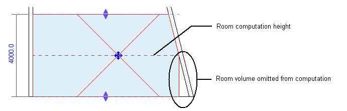

Note that Revit LT may also omit parts of the room from its volume computations due to a combination of sloping walls and the defined computation height.
