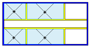

If you try to place a room between walls in the host model and walls (or other elements) in a linked model, Revit LT does not automatically recognize the room-bounding elements of the linked model. However, you can force Revit LT to use the room-bounding elements of a linked model.
For example, the following floor plan shows rooms being placed using the room boundaries defined by walls in the host model (blue walls) and walls in the linked model (yellow walls).
