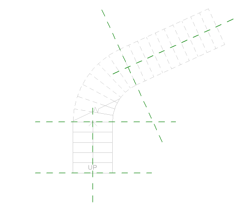

Use the Reference Plane tool to draw reference planes to use as a guideline in your design.
Video: Adding a Subcategory to a Reference Plane
Note: This video was recorded using Revit. When performing the procedures using Revit LT, you may notice minor differences in functionality and user interface.
Reference planes are an integral part of family creation. Reference planes display in each plan view that you create for a model.
Topics in this section
Add a Reference Plane
Use the Line tool or the Pick Line tool to draw a reference plane.
Name Reference Planes
Name each reference plane so you can assign it to be the current work plane.
