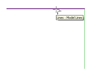

- Select the first element to fillet.

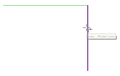

- Select the second element to fillet.
- Move the cursor and click to define the fillet arc.
