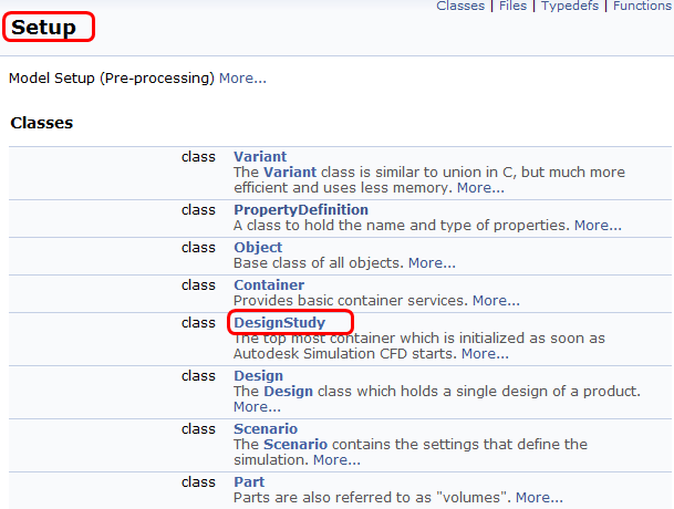

>>> In the header section, each module to be referenced in the script must be declared. All are from the CFD project. Click Modules in the Programming Reference for the list of modules:

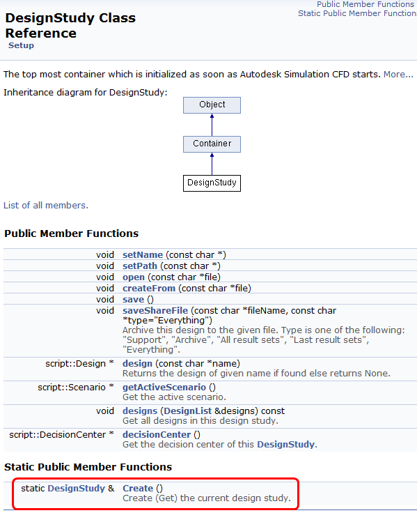

study = Setup.DesignStudy.Create()
>>>This line declares the variable called study. It is in the Setup module, the DesignStudy class, and the Create method. This is also how to get the handle on the design study. It is not necessary to specify the design study name because there is only one open during an Autodesk® CFD session.
Click Setup on the Modules page. The following page opens:

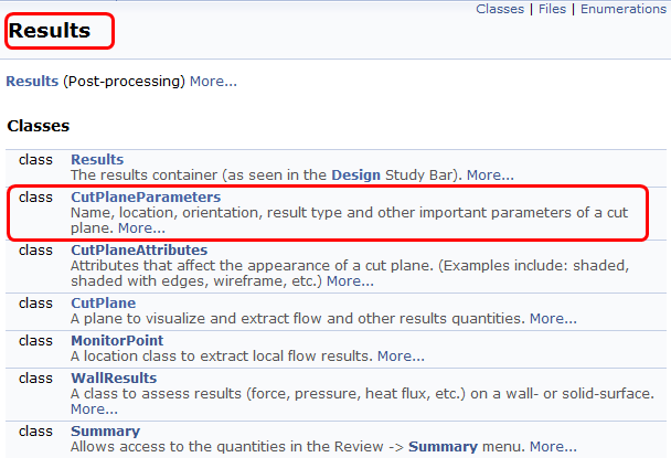

params = Results.CutPlaneParameters()
>>> Initialize the parameters needed for the results plane. Click Results on the Module page to access the CutPlaneParameters class:

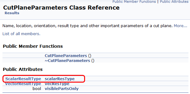

params.scalarResType = Results.VELOCITY_MAG
>>> Set the displayed scalar type on the results plane to be velocity magnitude. ScalarResType is a class under CutPlaneParameters:
To see the list of available enumerators, click the ScalarResType link. VELOCITY_MAG is enum for the velocity magnitude scalar:

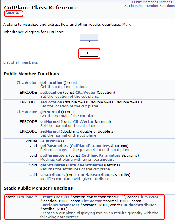

cp = Results.CutPlane.Create(results, "Cutplane1", location, normal, params)
>>> Create the results plane using the arguments defined above. The command is formed from the Results module, CutPlane class, and Create method:
The arguments list is formed from the results variable described above to get the results of the scenario. The name of the cutplane is defined as the following:

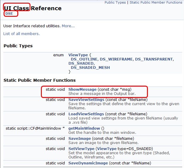

DSE.UI.ShowMessage("Cutplane created!")
>>> Display the message "Cutplane created" in the Output bar of the user interface. This command is formed from the DSE module, UI class, and the ShowMessage method:
