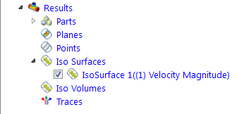

To Create an Iso Surface
To rename an Iso Surface
To select an Iso Surface
To Hide an Iso Surface
Note: A hidden Iso Surface is not displayed, and cannot be modified. Hiding one or more is often useful when capturing images.
To Delete an Iso Surface

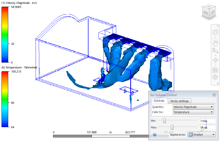

An Iso Volume is the volume of a model that falls within a specified range of a result quantity value. Unlike an Iso Surface which shows everywhere in the model that has a single, specified value, an Iso Volume shows everywhere that falls within a range of that result value.
The following shows an velocity magnitude Iso Volume colored by temperature. The shape of the Iso Volume indicates everywhere in the model that falls within a specified range of velocity magnitude. The colors indicate the temperature.
You can create and interact with Iso Volumes by clicking the Iso Volume command on the ribbon. The workflows for using Iso Volumes are very similar to those of Iso Surfaces.
