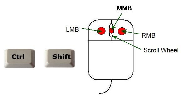

The mouse modes are summarized in the following tables, and use the following abbreviations:
LMB
Left mouse button
MMB
Middle mouse button
RMB
Right mouse button
Scroll Wheel
Rotate the scroll wheel
Ctrl
Press and hold the "Ctrl" keyboard key
Shift
Press and hold the "Shift" keyboard key
