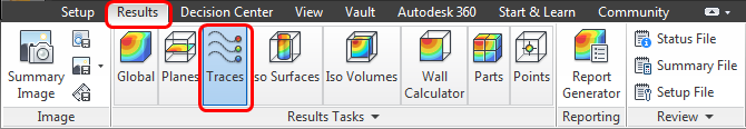

1. The next steps are easier if we delete the results plane. Click Remove on the Planes context panel:
2. Click Traces from the Results tab:

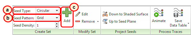

3. We can create traces on nearly any surface in the model, but the inlet is often the most convenient place. To create traces:
a. Set the Seed Type to Circular.
c. Click Add.

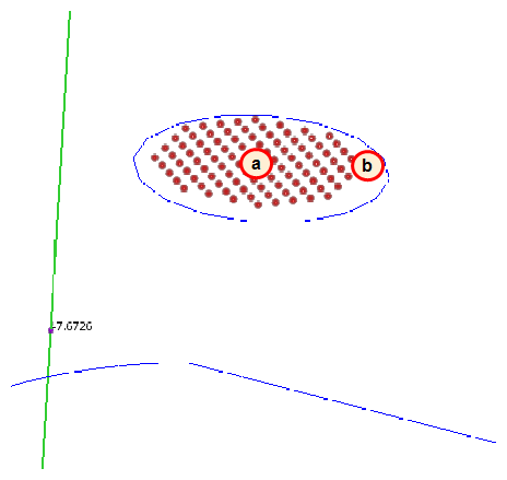

4. To create the trace seed grid:
a. Click in the center of the inlet.
b. Drag the grid to the outer edge of the inlet.
You should see this:

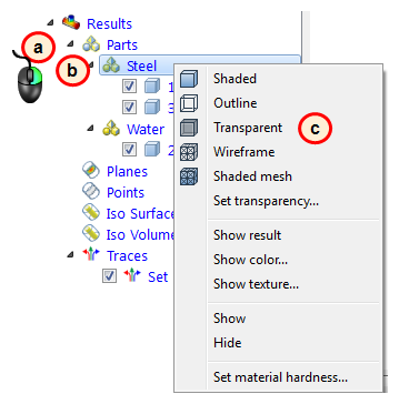

5. To display the pipe and poppet transparently:
a. Expand the Parts branch (under Results) in the Design Study bar.
b. Right click on Steel.
c. Click Transparent.

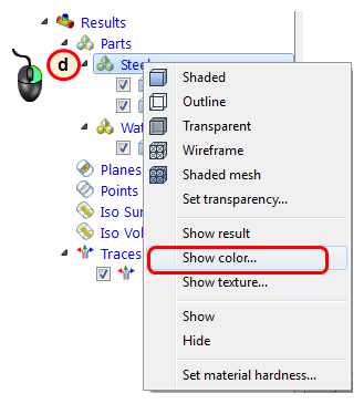

d. Right click on Steel again, and select Show color...
e. Select this color on the Select Color dialog, and click OK.

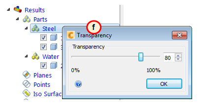

f. To see the traces better, right click on Steel again, and click Set Transparency. Drag the slider to 80%.

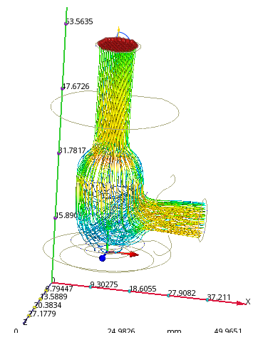

That's better! This helps us understand how the flow moves through the valve. The traces are colored by velocity magnitude, so we can also see how the flow accelerates as the water enters the outlet pipe.
