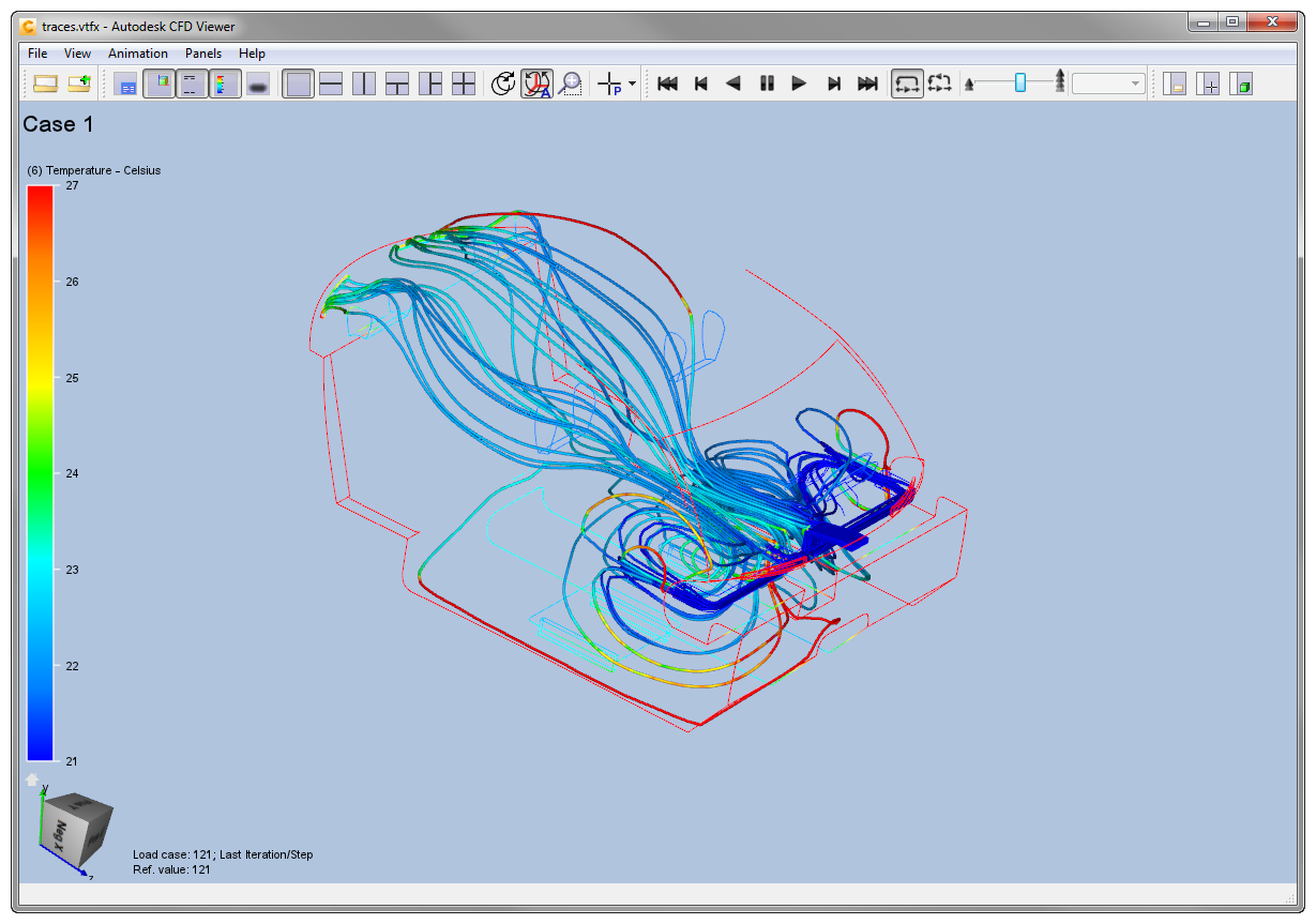

Main Window
The Autodesk® CFD Viewer is shown with a results set loaded:

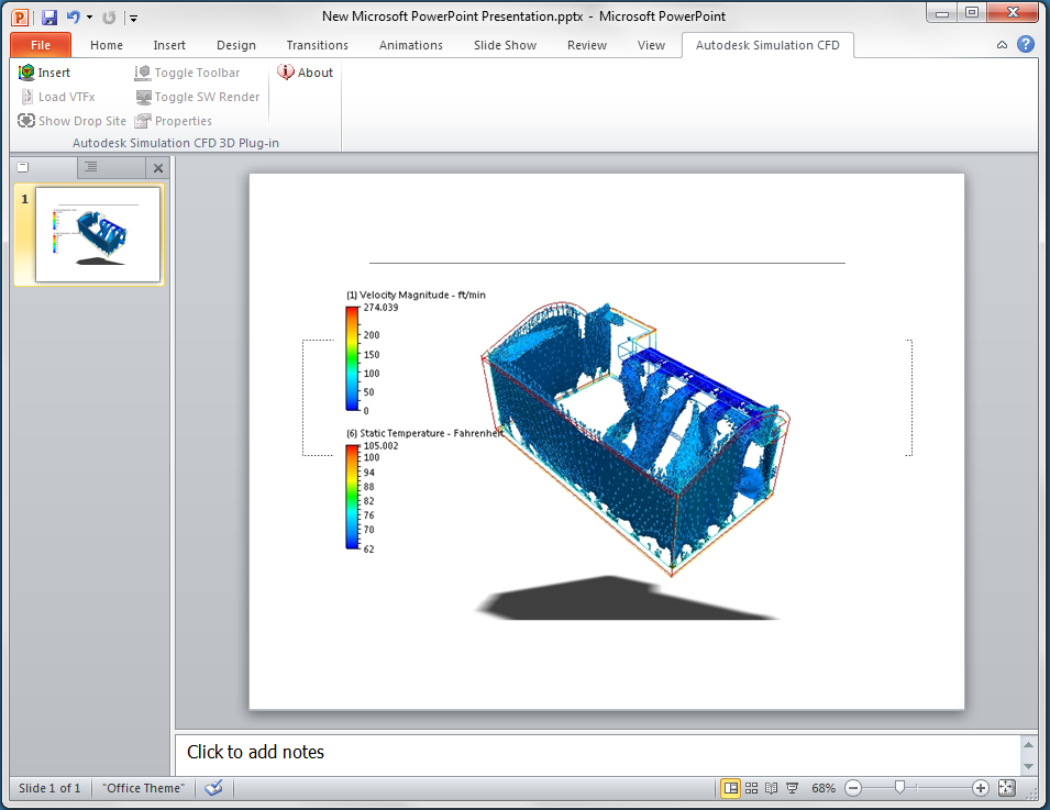

The CFD 3D Viewer has connections to Microsoft® PowerPoint and Microsoft® Word. These enable Dynamic Images to be a part of your Office presentations and documents.

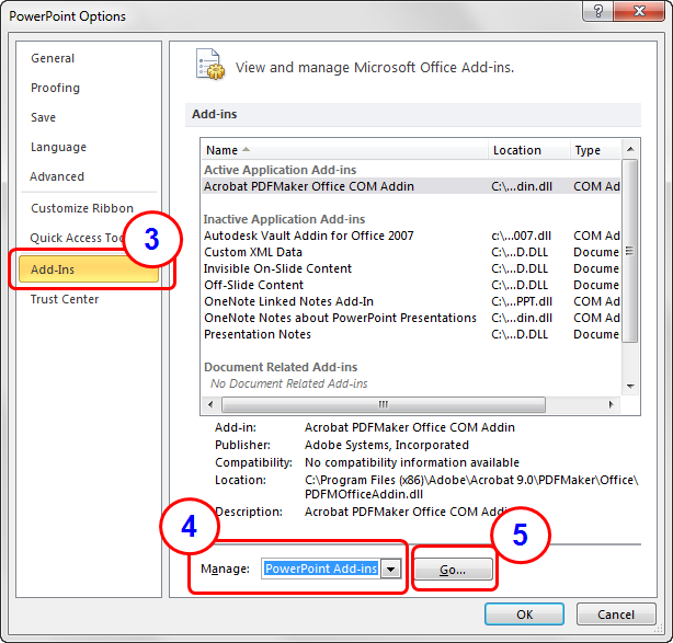

To add the CFD Viewer Addin

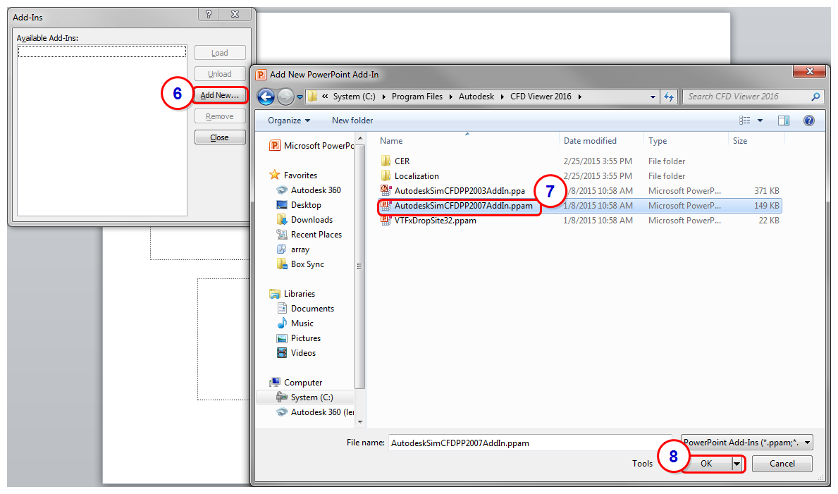

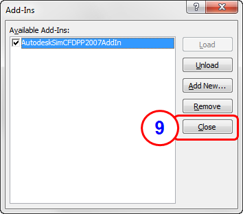

Before adding a Dynamic Image for the first time, add the CFD Viewer AddIn:

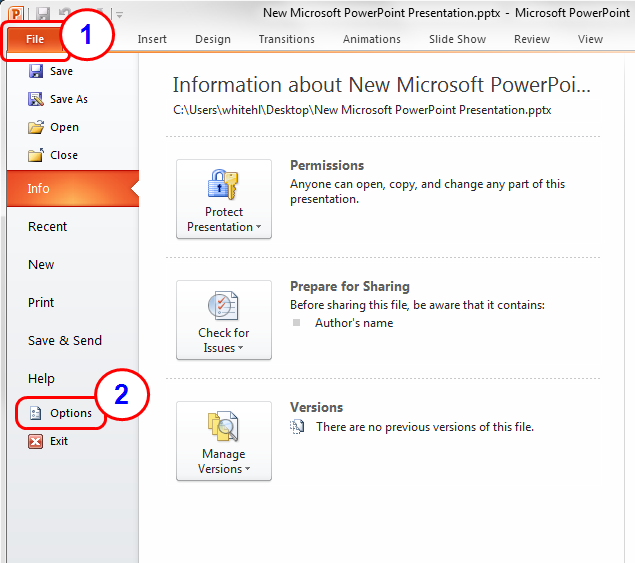

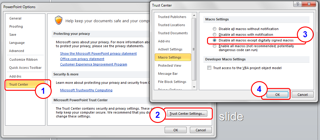

If the button does not appear, reduce the PowerPoint security settings:

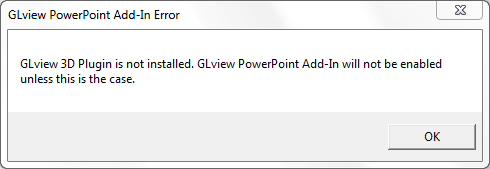

If you see the following error, the required plug in is not installed on your computer:
To download and install the free plugin, click this link: http://ceetron.com/products/end-user-products/glview-3d-plugin. Note that this opens to the Ceetron® website.

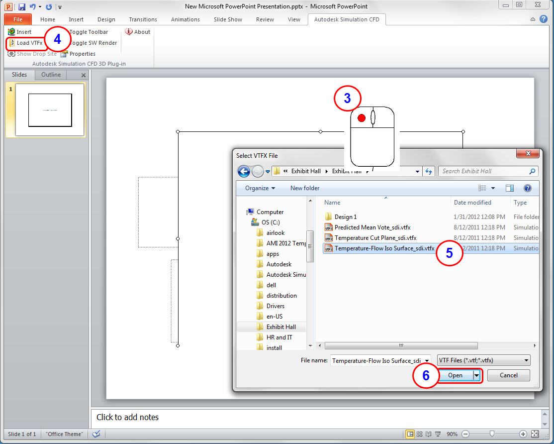

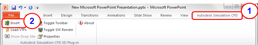

To add a Dynamic Image:

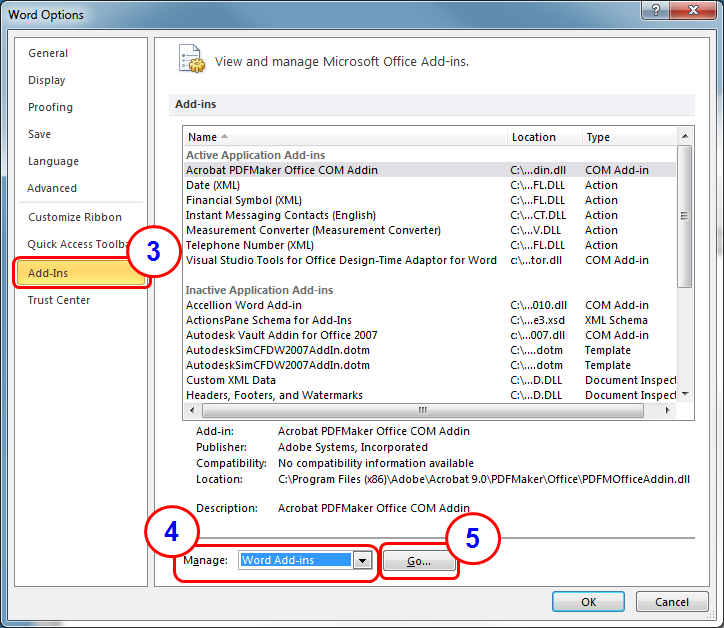

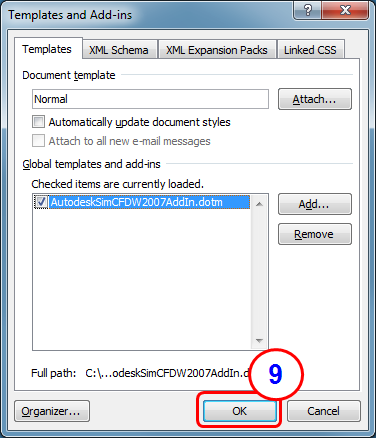

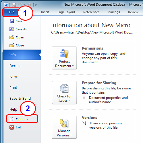

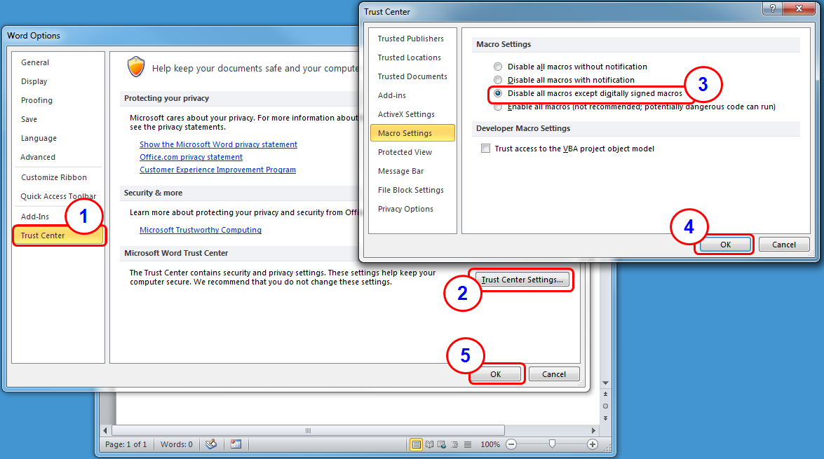

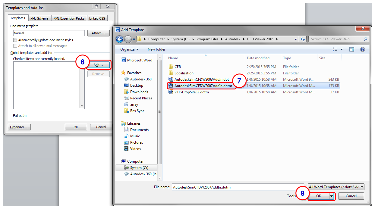

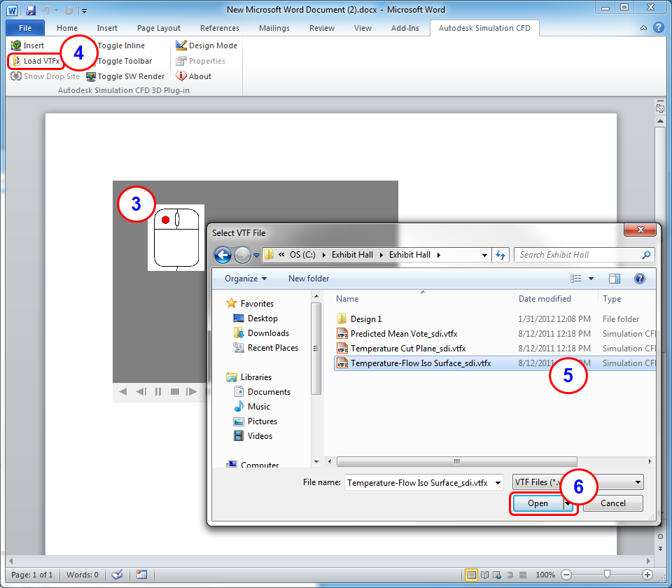

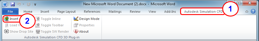

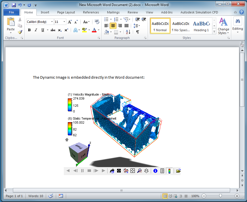

If the button does not appear, reduce the Word security settings:
